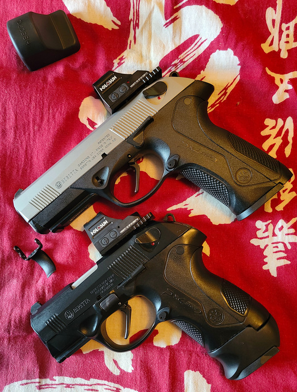

I started out just to upgrade the triggers to flat, steel triggers instead of the curved plastic originals. Langdon Tactical has all the stuff I want but a lot of it is out of stock. I did get the triggers and a new chrome silicon 11# hammer spring for the subcompact and figured I'd go ahead and polish all the friction surfaces in the trigger group and install the new trigger and hammer spring. This way, I learn how to disassemble/reassemble the pistols so when I get all the new stuff It'll be a snap. Figured it's take a couple hours - took me an evening and most of a whole day. But I learned lots and the trigger job on the subcompact is everything I'd hoped for sans the performance trigger bar whose ETA is unknown. Steep learning curve for me.
Trigger in the SC is freaking awesome with a lighter DA and SA pull and everything is crisp and smooth. Can't wait to install the performance trigger bar in the SC and a "Trigger Job in a Bag" in the full size. Both of these are carry guns so along with new holsters to accommodate the RDO's and performance optimising the triggers and actions has got me feeling pretty good.
