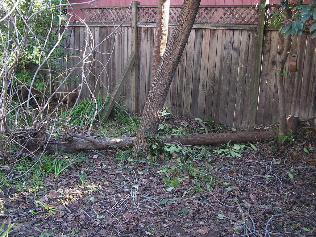

When we bought this house in 1992, this pecan seedling began to grow right next to the fence in the rear of the back yard. As it grew, I topped it and cut off any branches lower than about nine feet from the base to give the wood no knots. I also did not want a 90 foot pecan tree to cut down. Each winter I'd cut off the branches above that large burl at the top. You can see the one year growth there. That burl and the one just below it will yield some neat looking bowls. But it's the bows hidden in the trunk I'm after.

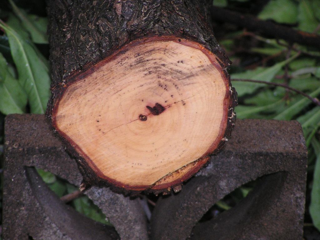

I counted 22 growth rings.
My next step will be cutting the two burls away from the log. Then I'll split the log lengthwise with two wedges and a sledge hammer. Then I'll wire it back together and stand it up in my garage for a year. Then I'll split each half once again. This will give me four bow blanks. Maybe more. I'll see in a year.

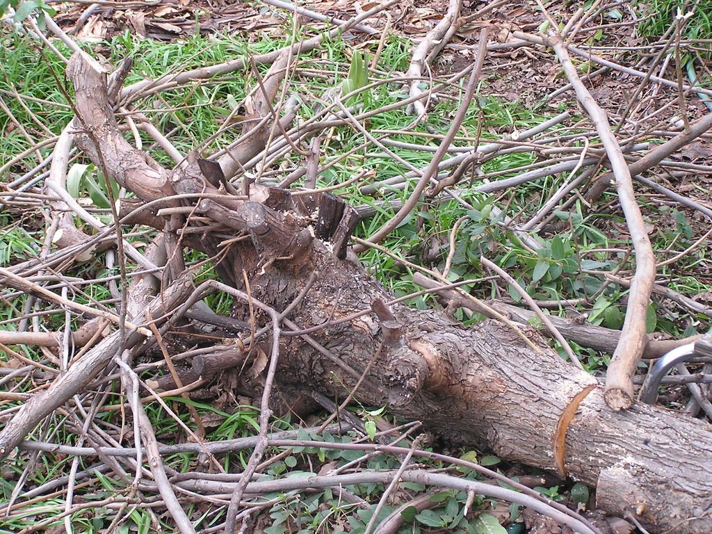

Here are two of the bowl blanks in there.
You see all the years of cut off branches there. All these branches will leave little bullseyes in the wood for me to find when I go in there with my old lathe and get the hidden bowls. On the right of the cut you can see one branch that got missed. It's about eight feet from the bottom, so when I cut it off--might be a bowl in there, too--I'll have about seven or so feet to get six foot bow blanks out of. Should work. I might not split the log for a week or so, as rain is coming.

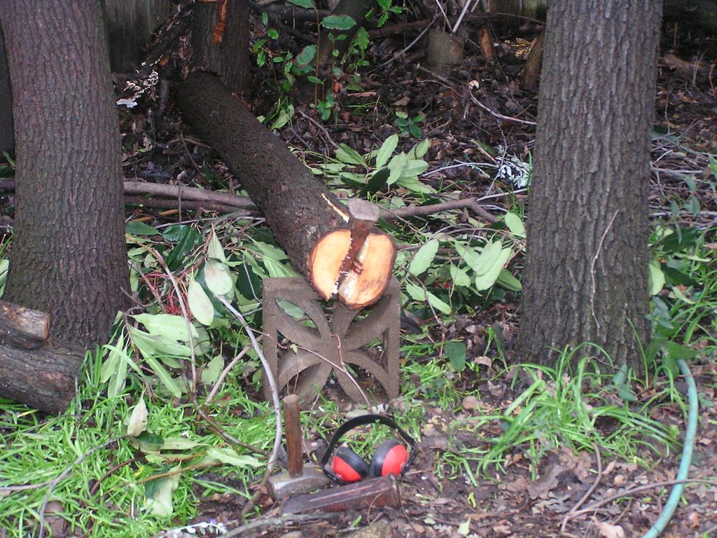

I cut the two boles off where the bowls are hidden, leaving this. It's been raining for some days, so this was taken while dodging rain drops. You wait some days after falling the log to let it show you where to do the first split.
Here it is.
I'll put a wedge in there and whack it until the split makes it through the bark, then I'll put in the other wedge on the outside. I'll whack it till the split heads down the log, then alternate until it's in half. There are no knots, so it should go pretty smoothly. I'm leaving the bark on to slow down how quickly the moisture leaves the wood. After I split it, I'll wire it together and stand it up in the basement for a year or until I can't stands it no more. Then I'll quarter one of the halves and start the first bow.

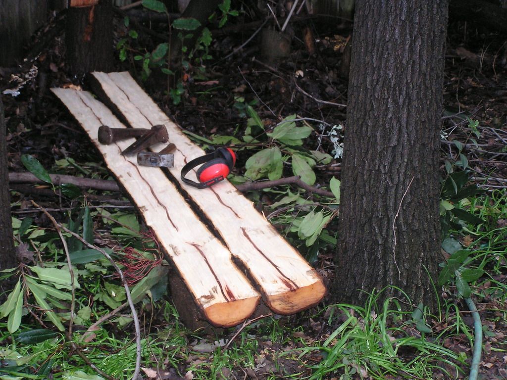

During a break in the rain, I was able to split this guy. Because I let it tell me where to split, this took about seven minutes. Pecan is very coarse grained. This splitting will allow me to shape the bow along the fibers of the wood.
You can see that little vein of heart wood running down the middle.
I laid it bark up, as it was starting to rain again. Wunderground says maybe a week of rain, so I'll wire it up next weekend.

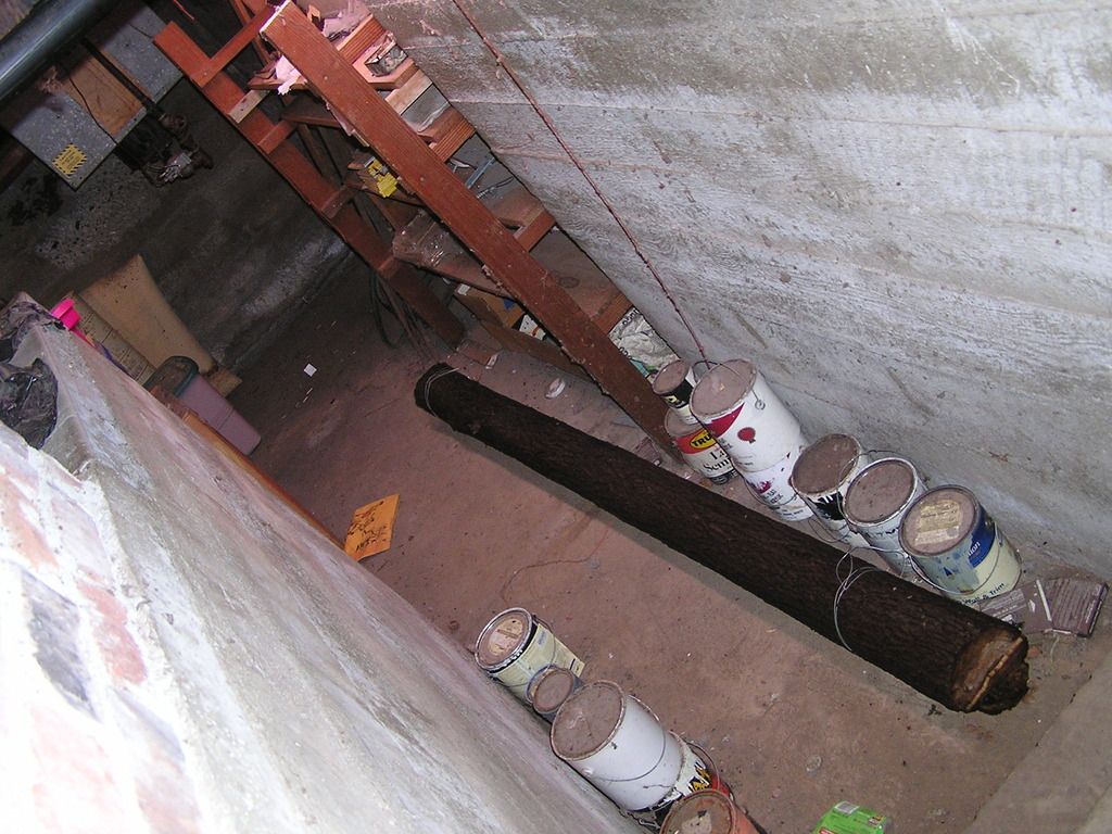

Mid October sometime is when I go down in the basement and light the pilot light on our 1927 floor heater--made in this very town back when we made things in America. The sheet metal fabricator shop name-stamped on the side is now a pizza joint catering to students of the near by university.

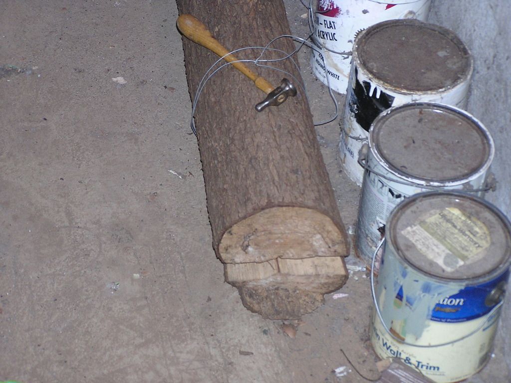

When you look at the pic of the log lying on the basement floor, perhaps you can see how tight the wire was wrapped. A couple weeks after I put it down there I was down getting something or other out, and I saw that the wire had prevented the log from warping into a U shaped thing--very tight wire.
So today the wire is loose, and the log has shrunk. I can see in the end grain the characteristic features of pecan, like hickory, the rays and texture. I'm looking forward to December when I'll take off the wire, split one of the halves in half, and restash the free quarter back down there. Then I'll have the first quarter log so I can start hacking out a bow.

The best weapon, as we all know, against the eight legged Mythical Basement Badass, is the chasing hammer, left over from my manufacturer's jeweler's stint in the dim dark days nearly beyond recall.
You can see how relaxed the wire is there. I slid the log to show some inner wood, but the flash didn't resolve it well. Looks like pecan.
Great big gobs of greasy grimy spider guts are off camera.
